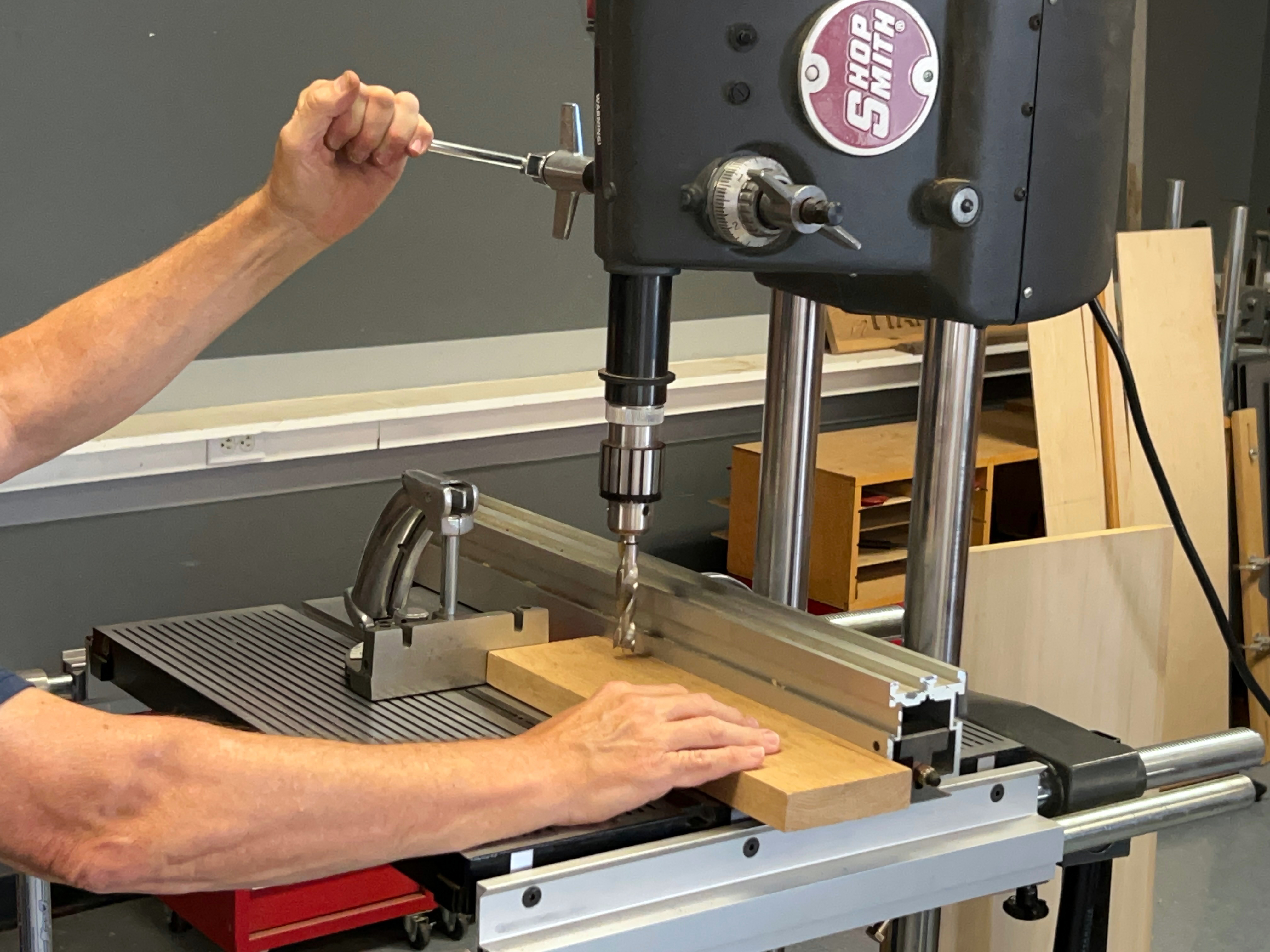

Drill Press Tips:
  • Use a sacrificial backer board to prevent blowout. Clamp backer board so drill bit goes
    into the same exact spot or move the backer to undrilled position each time.
  • Adjust speed based on material and bit size – the larger the bit, the slower the speed.
  • For the cleanest hole, use Brad Point drill bits and set the depth stop so only the point
    cuts through. Then flip over the workpiece and use this point-hole to guide the Brad Point
    through from the back side.
  • Lock the depth stop for consistent results.
  • Mark centerlines and use a center punch to avoid bit wandering.
  • Use the Rip Fence as a guide for multiple holes on the same centerline.
  • Use clamps to hold small pieces securely.

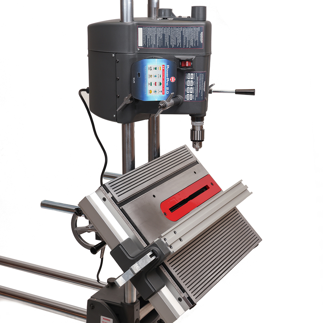

  • The PowerPro touchscreen allows speed control from 250 to 10,000 RPM.
  • Position the table in-and-out with a simple crank, and use tilt features for angled holes,
    such as screw pockets.
  • The rip fence mounted on the table tilted to a 45-degree angle makes an adjustable v-
    block for drilling round objects.
  • The sturdy construction and built-in depth stop help avoid over-drilling.
  • The telescoping support legs with connector tubes add extra sturdy, 4-corner support,
    under the heaviest workpiece when drilling.
