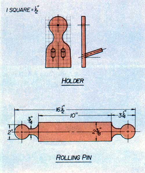

Start by gluing-up your stock to create a 2-1/2″ x 2-1/2″ x 18-1/2″ block. To achieve the slanted grain effect, glue up a block that’s at least 7″ to 8″ wide, then use your Bandsaw to slice the stock on an angle. Glue everything together using waterproof resorcinol or polyurethane glue, so the Rolling Pin can be cleaned with soap and water after each use.
Cut on a bevel, turning the stock will open up a lot of beautiful grain, but you’ll want to be careful that the exposed plies don’t catch your Lathe Chisel and tear themselves as you turn the Pin.
Mount your stock between centers. To prevent burning, use a Ball Bearing Tailstock Live Center. Start by using your Gouge to rough your blank down to a smooth cylinder. Maintain a gentle grip on your chisel to avoid abrupt movements and prevent unnecessary fatigue caused by gripping it too tightly.
First, use a pencil to mark the handle locations, then use an Outside Caliper and your Parting Tool to establish the diameters of the middle portion of the Pin and the Handle Knobs. Then, return to your Gouge and cut the Knob nearest the Tailstock first – making each Knob as wide as it is thick.
Switch to a Roundnose Chisel to create the sweeping transition areas from the Knobs to the Pin Body.
Once the basic shape has been turned (and while it’s still mounted on the Lathe) sand the Pin with 80-grit, followed by 100-grit, then 180-grit sandpaper to achieve a super-smooth surface. Finish with Salad Bowl Finish or non-toxic Preserve Oil Finish.
Crafted from a 1/2-inch thick by 3-1/2-inch wide piece of scrap wood, the holder features 3/8-inch dowels and a 1/4-inch diameter hole at the top for easy wall hanging. It's as straightforward as that.
