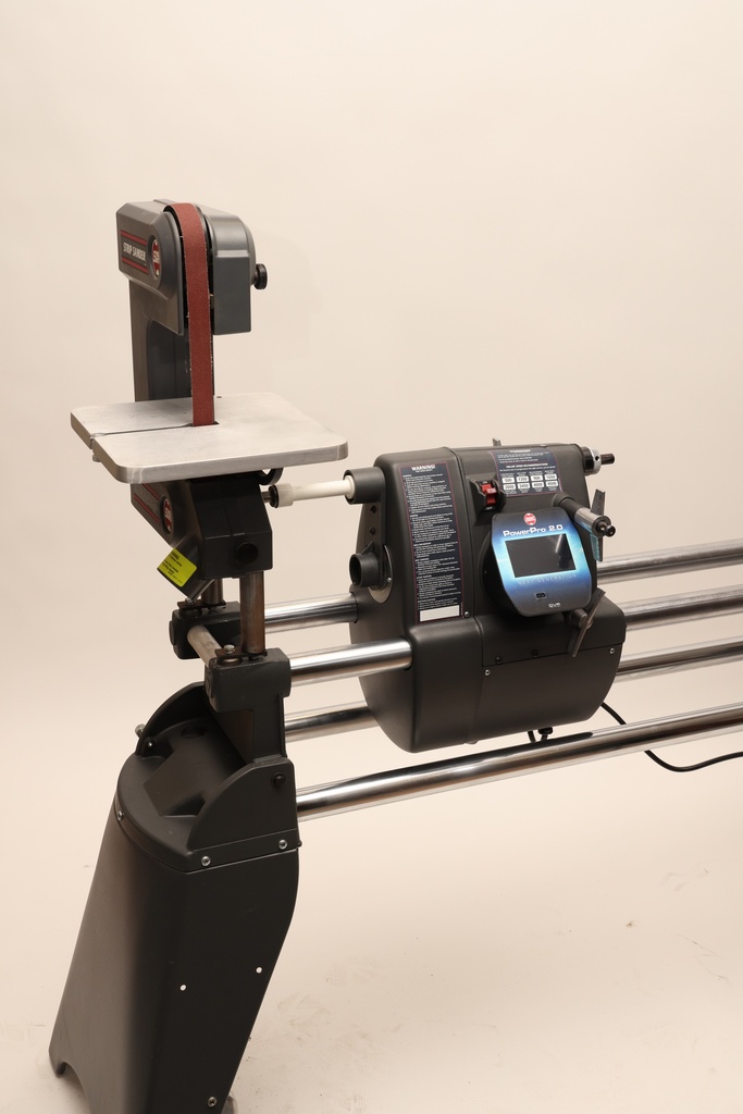

Eliminate tedious hand sanding, shaping, and tool sharpening. The compact, ultra-versatile ShopSmith Strip Sander handles fine detail work across wood, metal, plastic, and bone with ease. Supporting both 1" and 1/2" belts, it offers the performance of a full-sized narrow belt sander engineered specifically for intricate craftsmanship and tool maintenance.
Key Capabilities & Applications
  • Detail & Craft Sanding: Effortlessly smooth small edges, miniatures, and model components.
  • Internal Cutout Sanding: Thread belts through pierced openings to sand interior contours easily.
  • Sharpening & Grinding: Restore sharp edges to chisels, knives, scissors, snips, and outdoor garden tools.
  • Contour & Curved Sanding: Smooth external curves on valances and decorative trim using the exposed upper tracking wheel or by removing the platens for free-handing.
  • Multi-Material Shaping: Rapidly shape parts made from plastic, bone, non-ferrous materials, and wood.
Engineered for Accuracy & Efficiency

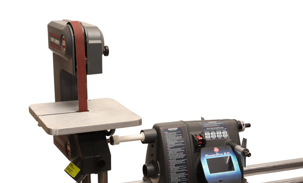

  • Die-Cast Aluminum Table (11" x 11"): Generous work surface tilts from 0° to 45° for rock-solid bevel control.
  • Interchangeable Platens Included: Comes with 1" flat, 1/2" flat, and 1/2" radius curved platens to match flat or contoured workpieces.
  • Hassle-Free Tension & Tracking: Spring-loaded mechanism maintains constant belt tension, while a single adjustment knob ensures true tracking.
  • Integrated Dust Port: Standard dust extraction port keeps fine wood particles out of your shop air. (Note: Disconnect dust collection before grinding or sharpening metal to prevent spark ignition).
