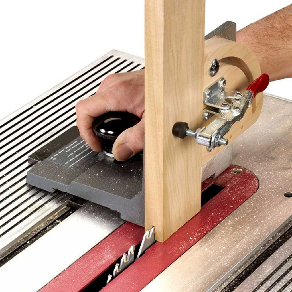

The Shopsmith Tenon Master Jig was designed with a wide, flat face that holds workpieces exactly perpendicular to Your MARK worktable top .
Although it is used primarily with the table saw for creating tenons on the ends of boards, it is equally useful for holding and guiding workpieces through all types of operations on other tools as well. For example, it can also be used to support and guide workpieces on your Shopsmith machine when using under-table routing
Made of heavy, cast aluminum work support, with a solid steel base, it offers a large, comfortable knob for optimum control and a built-in precision miter bar that fits your Shopsmith Mark 7 or Mark V worktable. The work support can slide 2” and for complete adjustment to match any project. The work support can also pivot 90-degrees so the Tenon Master can be set to not only cut the faces of the tenon but also cut the shoulders. The Tenon Master is not limited to tenons. It can be used to cut many other woodworking joints such as half laps, end laps dovetails and tongs.
A toggle clamp is included to help you grip the workpiece, against the pivoting Trunnion. Use this pivoting trunnion to back-up and support workpieces that have angled ends. For example, when cutting spline grooves for the mating faces of miters, such as those on picture frames and similar projects.
This is a very versatile accessory with numerous work-saving and precision-enhancing applications.
Includes: • Tenon Master Jig, • Wooden Pivoting Trunnion • Adjustable, Quick-Release Toggle Clamp • Instructions and • Plans for a Table Saw Panel-Raising Fixture
