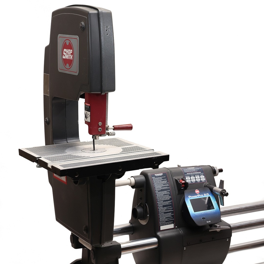

Unlock unmatched cutting versatility in your workshop. The ShopSmith 11" Bandsaw tackles everything from intricate scrollwork to heavy resawing and non-ferrous metal cutting. Handling stock up to 6" thick, it delivers speed, capacity, and straight-line or curved precision that standard table saws simply cannot match.
Key Capabilities & Applications
  • Tight Curves & Intricate Scrolling: Easily cut complex shapes and flowing curves in wood, plastic, and non-ferrous metals using blades from 1/8" to 5/8" wide.
  • Resawing Stock: Slice boards up to 6" wide on edge to create custom thin stock, book-matched panels, and veneer.
  • Resaw & Cut Thick Lumber: Effortlessly cut through thick hardwoods up to 6" deep for sculptured project parts and heavy construction.
  • Compound 3D Shaping: Cut matching contours on adjacent faces to produce curved cabriole legs, handles, and sculptural forms.
  • Stack & Pad Sanding/Cutting: Secure multiple layers of stock with double-sided tape to cut up to 6" of identical parts simultaneously.
  • Multi-Material Cutting: Safely slice through plastics, rubber, and non-ferrous metals up to 1/4" thick.
Engineered for Accuracy & Efficiency
  • Exclusive Unlimited Cut-Off Width: Reversible blade guides twist the blade 30° relative to the frame, granting unlimited length capacity for stock up to 3-7/8" wide.
  • Generous Precision Support Table (13-1/2" x 15-1/2"): Tilts 5° left to 45° right with a positive auto-stop at 0°. The integrated T-Slot ensures smooth, wobble-free operation.
  • Effortless Tensioning & Tracking: Set accurate blade tension without removing the safety cover using the built-in visual gauge scale. Features automatic blade tracking for simple setup.
  • Expandable Tooling System: Compatible with dedicated accessories including a rip fence, table extension, circle cutter, Cool Blocks, and specialty blades.
TECHNICAL SPECIFICATIONS
DETAILS
Max Depth of Cut
up to 6"
Cut-Off Capacity
10-1/2" Standard | Virtually unlimited with blade guides rotated/offset to 30° and stock under 3-7/8" wide
Table Size & Tilt
13-1/2" x 15-1/2"
Blade Width Range
Operating Speed
700 – 1,050 RPM (recommended)
Bearings & Weight
Sealed bearings (Ball/Roller/Needle) | 45 lbs shipping weight
System Compatibility
Powered via MARK system or Power Station (Power Coupler required)
Package Includes: ShopSmith 11" Bandsaw, 1/4" Combination Blade (Model 555419), and Instruction Manual.
