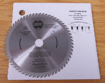

10-inch Carbide-Tipped Cross-Cut Blade (555960)
555960 60 Tooth Carbide-tipped Cross-cut Blade is the best choice if you're doing a lot of continuous cross-cutting. Its alternate bevel ground teeth are designed to quickly sever the wood fibers and deliver a super-smooth cut on hardwoods or softwoods. C-4 carbide. Use 1-1/4 inch arbor.
