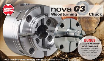

The NOVA G3 Lathe Chuck Package is exclusively manufactured for Shopsmith -- Only this Shopsmith package includes the T-Bar Wrench and the Wormwood Screw
The NOVA Lathe Chucks are precision machined to the closest tolerances from the highest quality steels. This premier quality, self-centering scrolling chuck allows you to attach and detach your turnings without leaving unsightly screw holes or having to glue scrap blocks to them that can be difficult to remove. A quick turn of the geared, T-Handled Wrench moves all four jaws smoothly and in unison to grasp your workpiece firmly. Other chucks use jaw profiles that are engineered to grasp hard materials such as steel or rounded profiles and often crush the wood fibers without digging in to hold the stock securely. The unique NOVA dovetail jaw profile and chuck gearing are carefully designed to hold the wood firmly without crushing it.
You can count on a secure hold, whether you're gripping end grain or side grain and feel confident that your gripping pressure will be spread over a wide area, helping to prevent damage to your workpieces.
The 1.889" long by 0.507" diameter Woodworm Screw offers a deep, fine thread that is precision machined all the way to the end of the screw, allowing it to lead easily into a 9/32" diameter pilot hole in soft woods (5/16" for hardwoods) and grip the wood tightly. It features a square shank and locating groove that locks positively into the NOVA chuck body.
The Insert Adapter is also precision machined to close tolerances from high strength carbon steel. It features a wide mounting face to eliminate wobble and is designed specifically for attachment to the 5/8" diameter Shopsmith spindle with your standard 5/32" allen wrench.
The Value Pin Jaw Set enhances your turning capabilities. This jaw set is designed to expand into a pre-bored hole in your workpiece. This makes it the ideal choice for turning bowls with free form edges. However, unlike pin chucks, which typically only work in a single sized hole, these jaws will grip a range of different hole sizes, so you won't be limited to a single size drill bit for this mounting hole.
The long jaws can be used to provide a powerful, more stable external (contraction) grip when turning miniature or smaller diameter spindles. Or for those times when you need to use an internal (expansion) grip on smaller diameter bowls, turned boxes and similar projects, it is included with your G3 purchase!

Features:
• Quality Materials and Precision Machining (body made from precision machined 1045 high tensile steel)
• Common Accessory Jaw Mounting Profile - compatible across all NOVA chucks and accessories
• High Tech Precision Composite Jaw Slides
• Special Woodturning Dovetail Profile on Jaws
• Auto Safety Stop Feature - Jaw slides can't protrude past the chuck body
• Open back for easy cleaning
• Comprehensive Instructions
• Common Insert/Adaptor Fitting - compatible across all NOVA chucks
• Safe Lock™ Woodworm Screw
Package Includes:
• Shopsmith NOVA G3 Chuck
• Pin Jaw Set
• Shopsmith Chuck Adapter
• 50mm Jaw Set
• Fasteners
• T-Bar Handle
• Woodworm Screw
• Instructions
