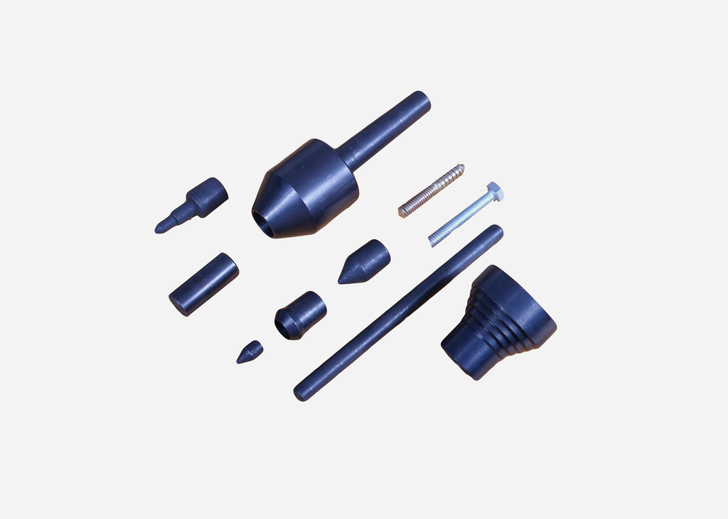

NOVA 10-Piece Lathe Live Center System Includes:
1. Ball Bearing Live Center Body - Massive 1-3/4" diameter x 2-1/8" Long Rotating Live Center Body
2. 60° Center Point - 11/16" Diameter 60°, #2 Morse Taper Center Point for turning large spindles and faceplate turnings
3. Hollow Cup Center - 5/16" through hole that's ideal for holding soft or green woods with less chance of splitting
4. Small Hollow Cup Center Point - 70° Tapered Point for the cup center
5. Miniature Extension Center - 2" Long with a 1/4" diameter x 5/8" long point that extends almost 1-1/2" from the nose. Good for small turnings like pens.
6. Double-Ended #2MT Threaded Insert - 1-1/2" Long, Double-Ended #2 Morse Taper Insert that offers a 5/16"-18 internal thread on one end for the screw (#7) or bolt (#8) below, either of which can be used to hold shop-made fixtures.
7. Screw for Threaded Center (#6) - 2" Long Screw (hanger bolt) for #6 above - featuring a 5/16"-18 bolt on one end and a coarse threaded screw on the other
8. Bolt For Threaded Center (#6) - 2" long, 5/16"-18 Bolt for #6 above
9. Stepped Cone Center - Nova-Exclusive Stepped Cone Center. It can be used in two different ways: #1: Attach it to the live center body using the insert (#6) above, the inverted cone will support either square or round stock without having to locate the exact workpiece centers. #2: Turn the center around and position its "cone" over the mating tapered end of the live center body. Now, you have a series of stepped diameters that can be slipped into holes or sockets in the workpiece. A very unique capability!
10. Knock Out Bar - 5-7/8" Long x 3/8" Diameter for removing centers from the live center body
