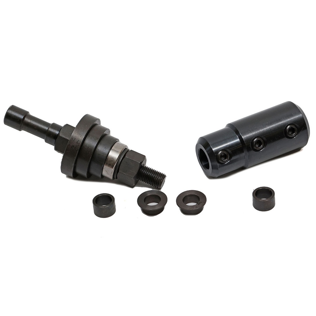

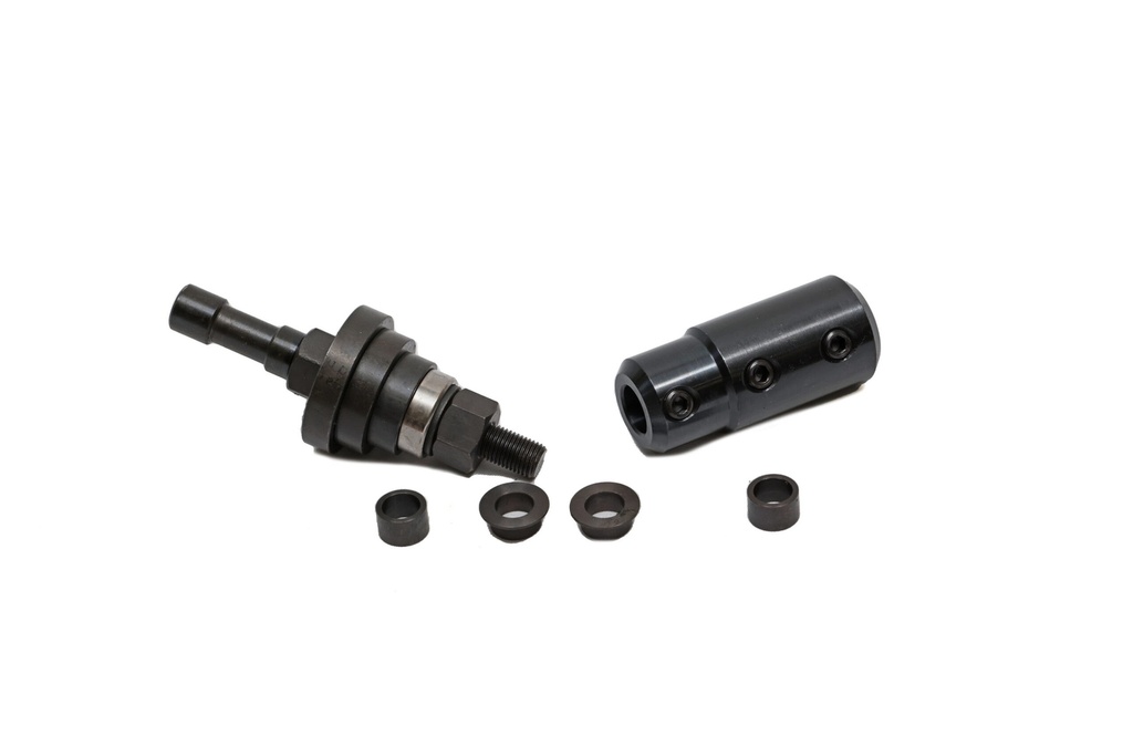

Ball Bearing Shaper Spindle & Chuck (556270)
Shaper Spindle with Ball Bearing Rub Collars and 1/2" Router Chuck. Works on all MARKs
Shaper Spindle Arbor Set - Ball Bearings (555472)
Provides improved finish cuts on both straight line and contour Shaping; burn-free results.
For use with the Speed Increaser (If you already own.) As well as with the ½” Router chuck to hold Shaper Cutters. Works on all MARKs
