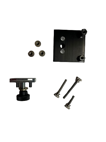

The Shopsmith Cross-Cutter allows you to make many cuts that have traditionally required custom jigs, fence adjustment, or tedious dado shimming. These cuts include:
• Making two cuts of differing length
• Making irregularly sized dado slots
• Making oversized dado slots
• Creating a double spline joint
Features and Benefits

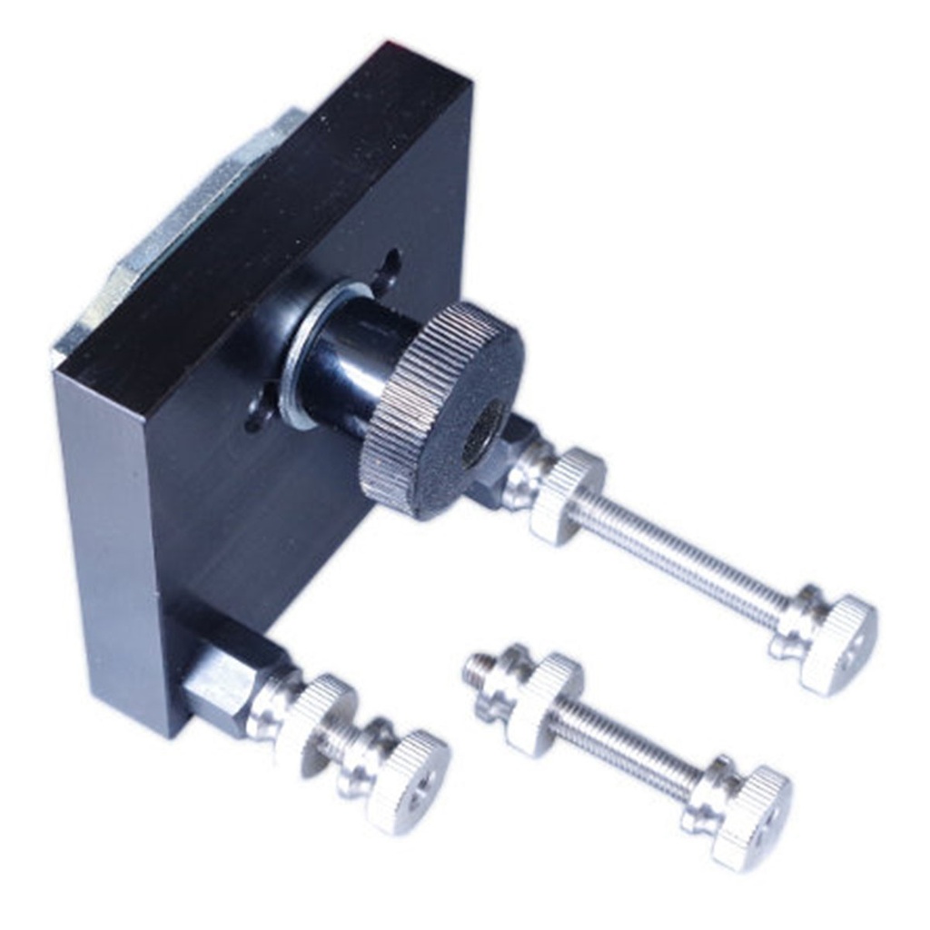

Safety: It creates a space between the rip fence and the piece being cross-cut. This keeps the workpiece from binding between the fence and the saw blade and creating a kickback.
Precision: The Shopsmith Cross-Cutter has 2 micro-adjustable stop screws. Each quarter-turn of the stops creates an adjustment of 1/128".
Uses:
• Cut multiple project parts to identical lengths after measuring only the first one
• Cut precise dados to exactly fit today's undersized plywood without tedious shimming
• Cut precise extra-wide dados that are wider than the capacity of your dado head
• Cut out imperfections in a snap
• Cut two slots (or dados) in the same board
• True up any variations in plywood for a precise fit
Note: Crosscutter (for MARK V 510, 505, 500) is part number 556464, Crosscutter (for MARK 7 / MARK V 520 / MARK 4) is part number 556466
